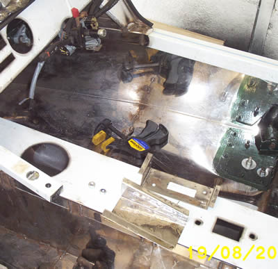

19th
Been really busy sorting out the garden and garage (old prefab and
the ends holding the roof down are rotten through) however I did
manage to get the steering rack all in place and I'ce alomost finished
building a new handbrake box (lowering it as per my build tops article).
Once I have the handbrake in place I can sort out the cable. Hoping
to get down the scrappies this week and get pedals/os hub and a
few other bits'n'bobs. I'm also on the lok out for an engine as
well now - having fantasies about the Rover v8 etc. but as my budget
is limited I think deviating form the basics is going to be too
costly. Perhaps I'll get it all done then think about an engine
swap if I ever have any spare cash again.
Steering column in place and box for handbrake

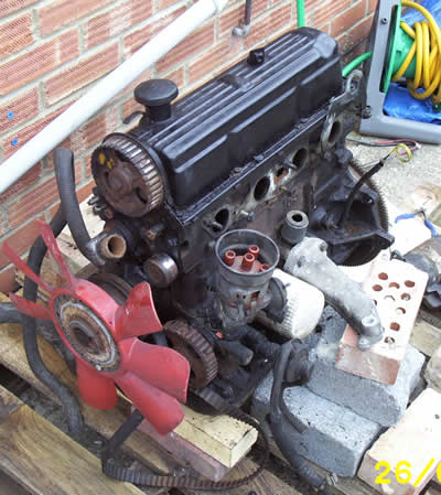

28th
Seem to of got the digital camera working again now so a
few more pics :)
Pinto block, not that bad from the outside looks??!!

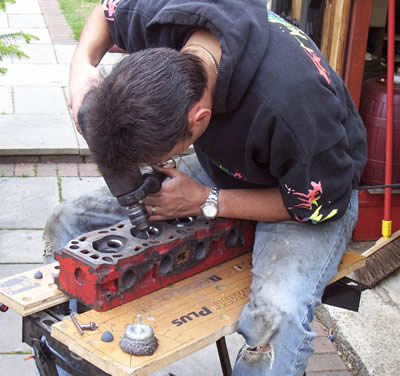

Modifying the head for better gas flow, thanks to
a bit of tuition from Dave Andrews - Won't be the best in the world
but will be better than standard. Basiclly I've just removing the
horrible steps in the inlet and exhaust paths - actually I'm not
even sure if this is a 1.6 or 2lt head at the moment! So once done
and cleaned it may be up for sale.
