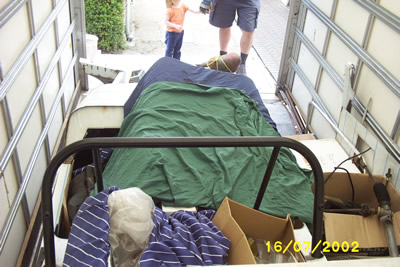

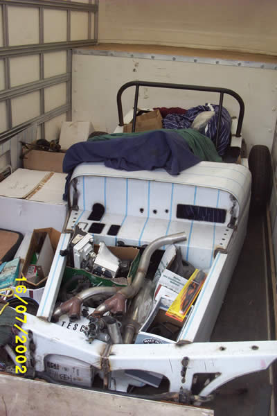

wet. The first thing to do was to move all the boxes out and wheel
out the chassis (Had back axle on and nothing else) so we wheelbarrowed
it to the back of the luton van then while holidng the front we
chocked the wheels onto the tail lift and went up...then it just
slid into place :) with that there (went in as planned - phew!!)
it was just a case of loading everything else around it. I was really
impressed with all the wotk Anthony had done in labelling up and
boxing things. Even the GRP / bonnet was covered in cloths so mine
where next to useless. This made the whole event real quick (and
a quick thanks to Anthony's granddad, for a real nice cup of tea).

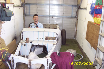

After catching up with a bit of work I decided to explore the car
again and try and remember all the little things to do.
Oh yes standard can't wait shot!
The back axle was in place and all looked ok, however
I decided to take it off and give it another good derusting (as
it had started to show a bit of rust again) and repaint it in green
(To go with the GRP which was in BRG colour)
As usual the minute I get in it the kids want in too!
